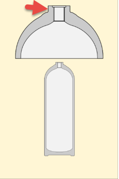

I am currently in the process of modelling a simple pressure vessel, to represent a SCUBA cylinder.
I have created the model with no problems and applied the pressure to the internal wall, however I am not sure on the accuracy of my results when I run the stress analysis.
I have calculated the hoop and axial stress by hand, and cannot see what Inventor classes these stresses as, with no figures seeming to relate. Are they the 1st Principal stress, or for example the YY stress (if the cylinders length is in the Y axis).
After reading the forums it seems my problem may be in the constraint, I have currently constrained the bottom face of the cylinder using the 'fixed' option. There was mention of creating three points on the base and constraining these in a certain way, however when I tried this it just created a large stress raiser at the base.
Attached is a screenshot with the model as it currently stands. (The small stress raiser on the face is intentional and is to model impact damage, this was added well after the problem arose, I assume this does not affect the rest of the model drastically?).

#3 I would model your tank more like the actual geometry and place the Fixed constraint at the neck.
The gas pressure would be against every internal face - I noticed that you missed a couple of faces.

If the overall intent is to analyze the "damaged" section, why not model just the cylindrical section, applying internal pressure to the interior surface, fix one end against longitudinal displacement (fixing additionally as appropriate,) and apply tension to the opposite end as hand calculated from the pressure and cross sectional area of the internal volume?
The rest of the model is of little interest in the calculation and adds enormous overhead to the analysis. If it's the body of the cylinder that's damaged the ends are not likely to fail. (If the bridge is near failure, don't examine the handrails.)

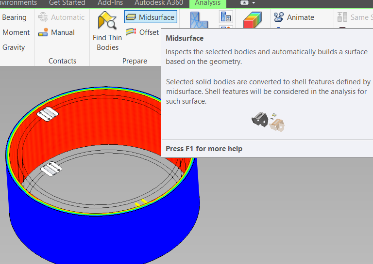

1. Did you look at the Hoop Stress file that I attached above.
Inventor will also do Thin Body (midplane) analysis.
I checked it both ways and the results were not significanlty different.
2. I misunderstood the original question.  Apparently it isn't about testing a testing a tank.  The real question is about verifying a hand calculated Hoop Stress value - in which case the entire tank isn't even needed and only serves to confuse the intent of the exercise.  (see posts 12 & 13)
