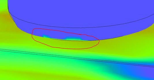

I am trying to run a stress analysis on a storage rack. I am running the test on only half the rack to see the forces involved. In the end this will be a boxed frame.
The rack will hold up containers with four small feet. Every scenario I try ends up putting the entire load in the center of the beam, which is not accurate. I created small pucks to simulate the container feet, and applied the load to their faces. The edges of the pucks are my highest stress points which bring my safety factor down to .1's while the frame remains unstressed.
I have attached a photo of where my actual load points will be. Is there a way I can apply these loads directly to the beam? Or a way to eliminate my puck edges from the simulation?
Thank you.

btaylor
Thank you for the response. Can you elaborate on how the split face technique would help here?
If I was unclear, the load points are separate parts which are placed on top of the box tube. As the box tube deforms it sort of pinches the edges of the puck (see photo below). I'm worried making the points too small would concentrate the forces too much.
In short, what is the best method to put multiple load points at specific locations across a face?

blair
You need to edit the beam, create a sketch that matches your "Load Puck" contact surface and use the Split-Face command. This will allow you to place a load within the designated circle. You would then need to do this process for each load circle on the upper beam.

Thank you Blair. I was able to figure that out.
The beam is a library part as you pointed out, but that will be easy to work around.
