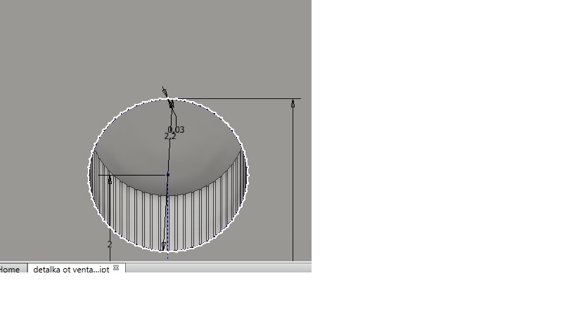

Hi!
I need extrude big circle and circular pattern of 100 items.
Sketch 12
Is there way to do it at once and not one by one?
The file is attached
Thank you in advance!

Circular pattern of what? Points?
The correct way is to create one feature and then pattern the feature, not the sketch.
Extrude the large circle.
Share the sketch.
Extrude the small circle.
Attach the new file here.

Yes, this is what I did.
I figured out it by meyself! WOW!!!!! :))
But anyway, I am intersting is there way to extrude circular pattern from skecth and not from the feature?
Yes, there is - but it would not be the correct way in this case.
But you have another problem - in your sketch you patterned only the center points of the small circle.  You didn't actually pattern the small circle.
When you get this part finished - attach it here and I will create a video of how the part should have been created.  (there are issues right from the beginning)
