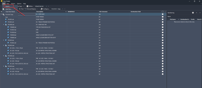

Hi @claudio.ibarra & @johnsonshiue, if you are using Vault there is a way to this. Select the assembly you want to export, and start a Copy Design process for this assembly. Select the relevant fields, I added the file extension field as I was only interested in the .iam files. Select File and Export. For large assemblies you need to type the filename as: Filename.xlsx as .xls is limited to a certain amount of rows. Once exported I filtered all non .iam files and removed these rows so that I was left with only .iam files. Hope this helps. Autodesk should add this as an option in the Inventor BOM export dialogue as its really handy to have.
