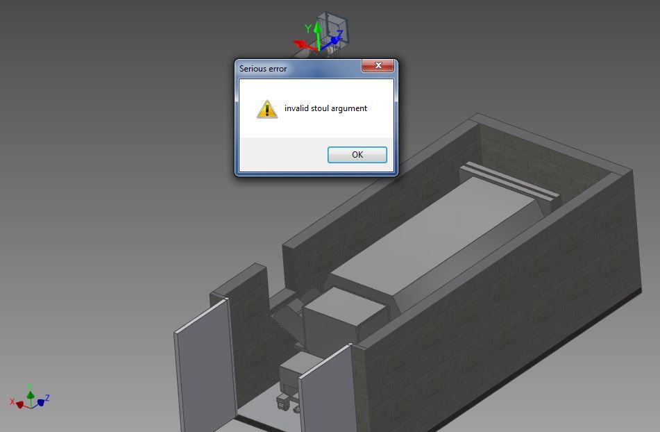

     Switched from 2019 to 2020 and files open fine, but when I try to place a component I get "Serious Error - invalid stoul argument". Anyone else having this issue?
     I've tried opening the part or assembly and saving before placing and still nothing. I also tried searching that error description and noting points back to inventor.Invalid Stoul.JPG

It would appear that this issue is being investigated.  Doesn't help you in the here and now I know.
https://knowledge.autodesk.com/support/inventor/troubleshooting/caas/sfdcarticles/sfdcarticles/Issue...
Are there some macro associated with this file you are trying to insert?

     As for the macro, I don't believe so. I've never worked with anything using macros in inventor that I am aware of.
     It did allow me to create a new assembly and place a component (same one that gave the error). So I guess the work around they suggested is good. Small inconvenience, but at least the components are usable still. I was worried that I would have to recreate all of my commonly used files.

The "work around" is junk. It works for the first component added, but after that it has the same error and also after you save. Then if you try to insert that component into a new assembly it has the error as well. I am thinking about uninstalling and going back to 2019. Kind of dead in the water here. Don't want to draw everything again.

This is a bug, INVGEN-29073. I checked the status. It is confirmed fixed in the coming 2020.1 Update, which will be available soon.

Yes, absolutely, the defect will be fixed in the coming 2020.1 update. The error message should not appear in any existing file or newly placed file. I cannot comment when exactly the update will be released. But, it is soon.
