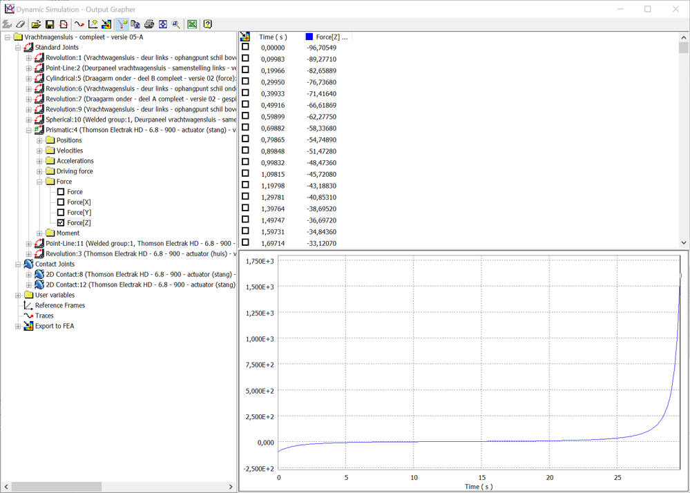

Hi there,
I’m having trouble understanding the Output Grapher in Dynamic Simulation.
I have a door, which I’m going to open and close using an actuator.
I set it up in Simulation and use an imposed motion on the prismatic joint in the actuator.
Then I use the output grapher to look at the force (Z) of the joint, needed for the actuator.
When I look at the force, there is a negative force showing.
How is that possible? I’m stuck on this one.
If there is anyone who can tell me what I’m doing wrong I would be very thankful.
Cheers,
Wap.

Wapster
Hi admaiora,
Thank yo for looking in to this.
I don't know if I understand your answer tough.
I know the joint is OK, but why is the force negative in the Grapher..?
The model is a simple model now, but I'm gonna add glass, (wind) pressure, and friction later.
The goal here is to find out if the actuator is strong enough but I first wanna know if I'm "reading" the Grapher the right way.
A negative force suggests that the door would open by itself (the first few seconds) only using gravity
I just don't believe that (and tested it removing the imposed motion), so I must be doing something wrong.
Thanks again,
Wap.

Message 7 of 8
jan_priban
Hi Wap,
basically when moving part (you door) is decreasing speed - decelerates, then force can be negative value. I think it could be your case, doors at initial position move faster than in the end position while piston speed/imposed motion is constant. See please the attached image what I am trying to explain. Speed in position 1 is faster than speed in position 2, due to angle change.
Regards

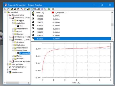

Message 8 of 8
jan_priban
Hi Wap,
see please my better answer/update
I created similar model,
And define imposed motion like you. Graph shows angular velocity of rotating door, see it is decreasing, means deceleration from start to time 2.8 sec. Than angular speed is growing, door accelerates. That's why Imposed motion force or FZ in prismatic joint has negative value to t= 2.8 s, after that positive.
and
Regards
Jan Priban
