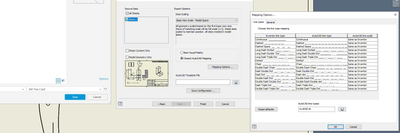

They are not multiple lines, they are just a single dotted line. If you open the dxf in AutoCAD you can just change the line style.
You can change the line style in the styles and standards editor, but that would look the same on your drawings which I guess you don't want.
You could also try the autocad mapping options when exporting to dxf, if that works you might be able to get that working through iLogic, but I'm not sure if there is API for that.

Change the line type scale in Autocad
