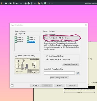

Double check on how your exporting the sheet. Use "Model Space" and not "Layout Scale" to force the title block and everything else to rescale to the model true dims. A lot of people don't do the drawing sheets properly to make the dim's 1:1. As Shoe has stated check how the *.dwg is opened in cad if my previous statement doesn't help.
