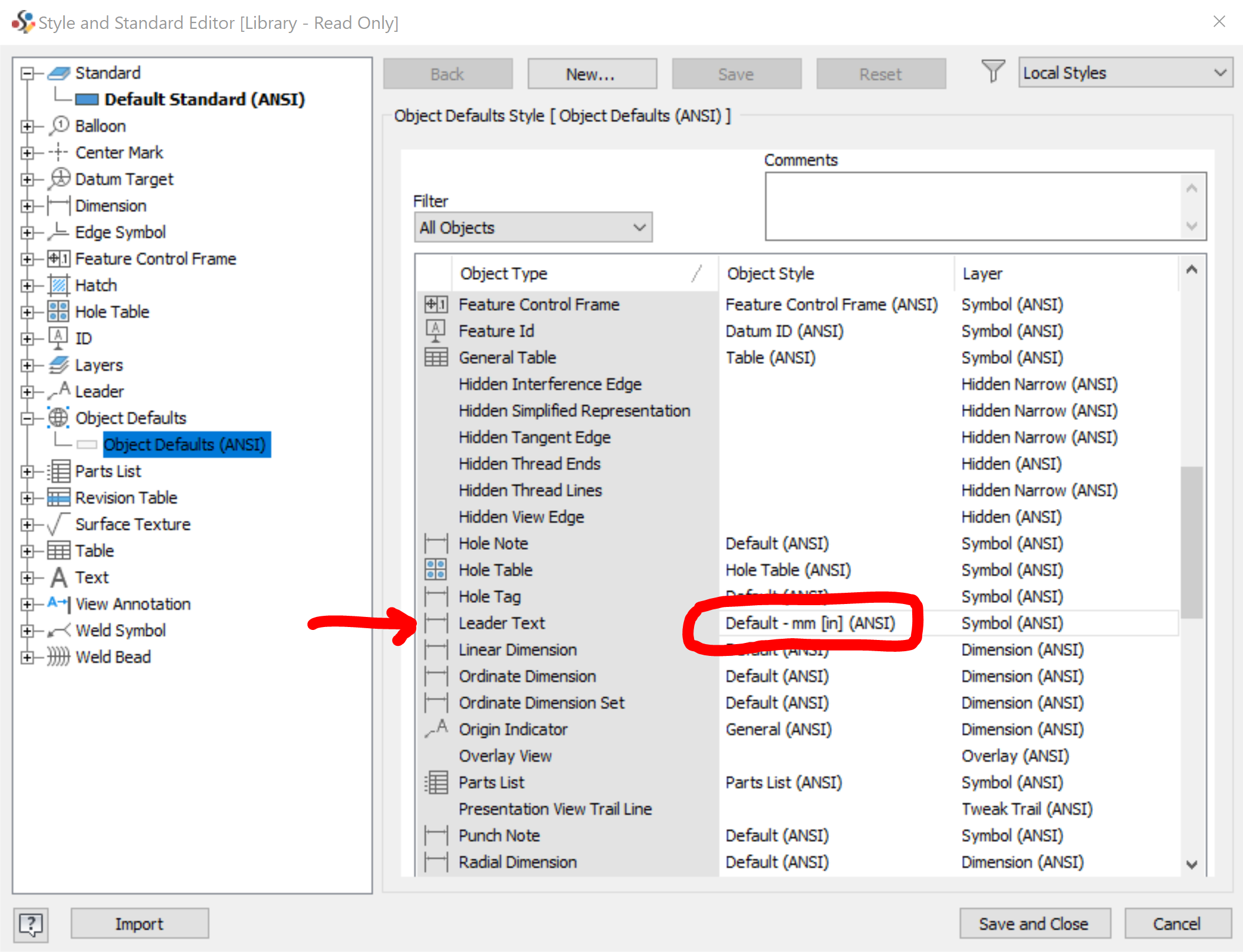

In Style Manager, set up the Dual Dimensions the way you want them shown in the Default-mm [in] (ANSI) style, or make a copy of that and set up the new style how you want it.  Then, in Object Defaults, set Leader Text to use the style you have just modified (as shown below).  I haven't tested this fully yet, but give it a try and see if that helps?

Didn't work.

Hi! I don't think such workflow is supported. The Leader Text treats parameter value as pure text. It is not aware of the unit. Only dimensions or hole notes support dual unit.
Please feel free to submit it to Inventor Ideas forum.
