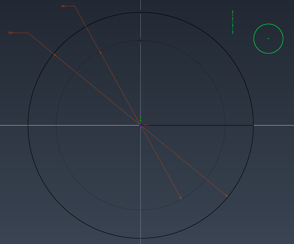

Here is the current setup I am using right now with dark theme and a custom color scheme
Is it me who just immediately after installing changes the theme? I don't think that should be the gut reaction.
Please tell me I am not crazy and the only one thinking and doing this. If I could change it to look like Fusion in the sketch environment with a click I would do it in an instant.
JDMather
I turn the Visibility of the axis off.  I don’t need them.
However, if you want to change the lineweights in your Template - you can do that...
I also increase the dimension text height for my old eyes.
mcgyvr
I agree that a "default theme" shouldn't be like that and that a new user may become frustrated before they know that they can address the issue via theme or template changes.
At least you know now that it can be modified to not be a problem.
Change thickness, change colors,etc...
Brodholm
Thanks for the tip! I actually did not know you could change the font size. Do you do that under styles?
But the linewidth is not something that goes as a global setting? You have to change that on the template, correct?
mcgyvr
@Brodholm  See tools...application options..general tab... "Annotation Scale"..
And yes the sketch line weight is not in the application options or theme and must be set in the template for everything going forward in time..
