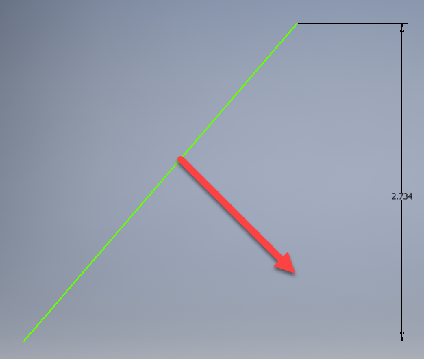

I'm having some trouble with setting dimensions on a diagonal line...
No matter what I do, the dimension is between the two points and is either vertically or horizontally aligned, however I need to dimension the line itself which would need the dimension to extend perpendicularly from the line (below image).
Surely this is possible to do in Inventor as this seems like a somewhat counter intuitive way to scale lines in a sketch.
Any help would be greatly appreciated as this is slowing me down somewhat.
Thank you.

JDMather
Aligned DimensionAligned Dimension
Click the line twice (not endpoints)
or
right click and select Aligned.
brad
When placing the dimension, right click.
There should be an option "Aligned".
Solved
Thank you very much for this!
How I overlooked this I have no idea.
