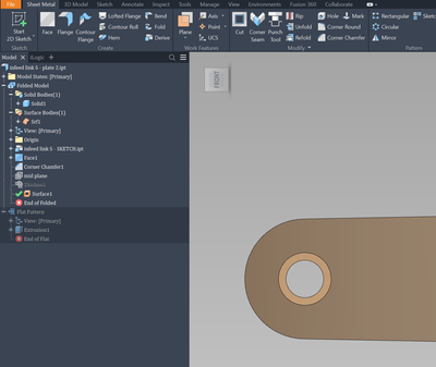

Yes, @kacper.suchomski it totally needs more explanation. So what happens is, say we have a flat pattern of a part which needs machining. Perhaps the outer profile is enlarged for this pupose, or some holes are filled in "smaller" for latter machining / removal of material. So when laser cutting I edit the flat pattern to add material where needed.
For programing I need both the "stock" profile and the "finished" profile of part. Unfortunately, in CAM I have to have 2 separate bodies for specifying first the "stock" part and then the "finished part" - model states won't do.
This is my current workflow. In the part to be machined I Thicken/Offset or Direct Edit the profiles which need machining (to what they will be cut - what is set in the flat pattern). Then I create a copy of the body as new surface and suppress the Thickened surface. Now in CAM I can select as stock the copied body and select the solid body as finished part (model body).
It can get tedious considering many, many parts. Also because of suppressing the Thickened surface and copying body, those links are disconnected, so updates to the part will not apply.
@Gabriel_Watson Yes I suppose that is a workable solution, save for the fact there will be no dynamic updates... No more links to the original part, in case of updates.
Does this make sense? Is there a better workflow that you all can suggest? I was thinking to create a new part in which I derive once the flat pattern and secondly the finished model, in order to have these 2 bodies to work with.
Many thanks!

I thought of two strategies:

Hi! Or, you may export the flat pattern as STEP. Then associatively import it to a new ipt file. When there is a change in the flat pattern, just export it again (overwrite the existing STEP file) and the linked Inventor part will update accordingly.

Does the CAM need 2 bodies?
Or it can be 2 files?
I used Model State for "finished" punch flat and a "purchased blank".
@Frederick_Law , CAM needs two bodies (Multisolid): One body to select as stock and the other is the part itself.
CAM will not import the flat pattern, so the only way i see is to unfold the model.
If you want to have associativity with the source file, i would go for the derive method, which @kacper.suchomski refered, then, unfold the part and create the extra operations.
