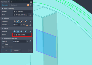

I have a solid body with multiple solids. I need to remove a portion from one of the solids. I created a sketch and applied the cut feature, but it did not remove. I don't know how to fix it.

tim11_manhhieu
If you want to apply the cut to a body, click to select that body.
Inventor defaults to the body containing the sketch.
