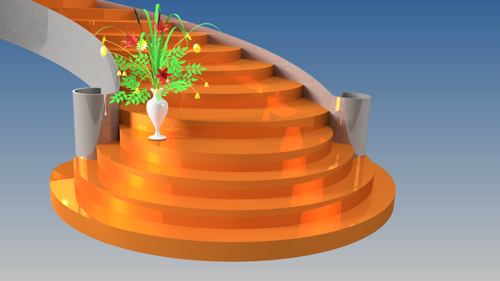

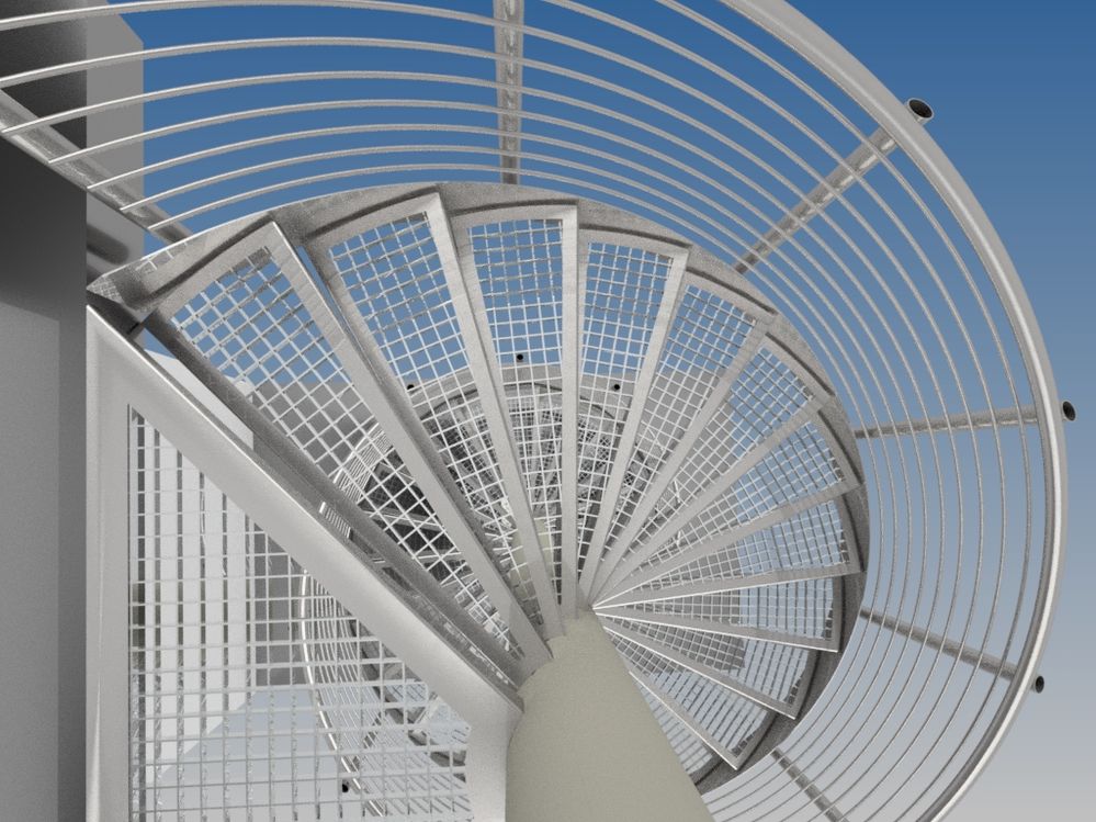

S_May
Hi @Anonymous,
this is not a problem, you have experience with Inventor???
Message 6 of 9
S_May
Hi @Anonymous,
here a pattern of such a staircase, the cheeks can be used as flahes sheet...
Message 7 of 9
