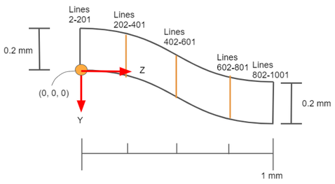

The following diagram is the side view of the fiber:
Note the directions of the X, Y, and Z axes and the position of the origin.
On the Excel file, each line is referring to each quadrilateral-shaped subarea of one of the five cross-sections, which is the reason why there are 12 vertical columns (x1, x2, x3, x4, y1, y2, y3, y4, z1, z2, z3, z4)- following the 1-2-3-4 convention for each quadrilateral subarea I mentioned in the initial post. Some combinations of XYZ coordinates are repeated on other lines because the left-side border of one quadrilateral subarea can be considered as the right-side border of another quadrilateral subarea.
Each of the five cross-sections across the fiber (located at Z = 0, 0.25, 0.5, 0.75, and 1 mm, as seen on the diagram above) is divided into about 200 quadrilateral-shaped subareas that form the grid pattern like the second image I attached in the original post (except in the image I drew the grid pattern only on one of the cross-sections when there should be five). In fact, lines 2-201 on the excel file refer to the cross-section at Z = 0 mm, and then so on (the rest labeled on the diagram above).
I want to create a mesh (for simulations) around and into the fiber on Autodesk Inventor 2021- from the cross-sectional view, the mesh creates the grid pattern on each of the five cross-sections by dividing each cross-section into quadrilateral subareas with specified XYZ coordinates for the corners (given by the Excel file). From the side view, the mesh follows the exact curvy path of the fiber to connect every quadrilateral subarea of one cross-section to the corresponding quadrilateral subarea of another cross-section. In other words, a mesh that divides the fiber into curvy subvolumes- kind of like 3D puzzle pieces that form the fiber when you assemble them together.

I believe I get it now.
Please explain why your detail in pic #2 shows a rounded corner @ 4:
Also, what connects the vertices between sections of the fiber (1.1 to 2.1 to 3.1 to 4.1 to 5.1, and so on)?
Or said a different way, these tiny fibers seem like a special kind of binding aggregate in a fiber-reinforced product.
So that would mean that you have to 'grow' this fiber a certain way to give it strength (per the cross sections).
It just seems like the mesh cells define FEA nodes in this fiber.

Thank you for your explanation!
I will try my best to answer your questions.
Q1. Please explain why your detail in pic #2 shows a rounded corner at 4.
My usage of "quadrilateral subarea" in the previous response is just a general term I used to refer to the shape of the subarea on a cross-section (plus, each subarea has four corners according to the Excel file). The subarea shape obviously gets more distorted from a quadrilateral the closer you get the edge (with curved boundaries), so sorry for the confusion there. Corner 4 is rounded because I was referring to the specific subarea near the middle of the first cross-section just to explain the 1-2-3-4 convention, and I thought a rectangle with one rounded corner best described that specific subarea. If you look back at the diagram, I drew an arrow pointing to a specific subarea on the cross-section shown with the grid.
In other words, please don't take "quadrilateral subarea" and the fact that Corner 4 has the rounded corner seriously- they are just general terms I used to describe the overall situation.
Q2. What connects the vertices between sections of the fiber (1.1 to 2.1 to 3.1 to 4.1 to 5.1, and so on)?
The cross-section grid pattern created by the mesh should be consistent for all five cross-sections. This means that every subarea on one cross-section has four other identical, corresponding copies on the other four cross-sections. I see that you have five cross-section grid patterns for the mesh- is it possible to connect every subarea on one cross-section to the corresponding subarea in four other cross-sections (using a specific curvy path)? I will provide the useful dimensions at the end of this paragraph, including the equation curve I used as the path for the Sweep function on Inventor.
Back to my comparison with a 3D puzzle, basically, think of the mesh as an extremely thin skeleton frame of the 3D puzzle that divides the fiber into multiple curvy subvolume pieces.
If your definition of a node is a point where mesh lines intersect, then yes- nodes should basically lie on the corners of the quadrilateral subareas, the XYZ coordinates for which are specified on the Excel file I provided at the beginning.
Yes- getting rid of the diagonal red lines to erase the triangular mesh pattern would be perfect!
The following diagrams specify the dimensions of the fiber.
The cross-section stays consistent throughout and all units are in mm.

Thank you for the additional insights.
I am writing this response to clarify parallel vs perpendicular extrusion and then to ask a few questions about the mesh feature on Inventor.
The reason why I drew the three orange grid mesh cross-sections in the middle parallel to the two black grid mesh cross-sections on the edges is simply because it's one of the requirements.
If you review the original Excel file, you will notice that lines 202-401 have a common Z value of 0.25 mm, lines 402-601 have Z = 0.5 mm, and lines 602-801 have Z = 0.75 mm.
I understand your statement that this requirement makes the task extra challenging, but the fact that about 200 lines have the same Z value implies that all five cross-sections must stay vertical regardless of the extrusion path.
I am currently an undergraduate student, so I was recently introduced to the concept of mesh.
I feel like understanding how the mesh feature exactly works on Inventor is the key to developing approaches, so please answer the following questions to the best of your knowledge.

Q1. Is the pic in one of my previous posts showing the snake-like extrusion representative of what you want to accomplish?
If you are referring to the picture included under "Message 11" (on 6/15, 7 AM), then that seems correct.
I assume each subarea of the grid mesh pattern is extruded to the corresponding subarea on the next grid mesh pattern?
Q2. Are all the grids the same on each cross-section, except for position on the plane?
Exactly. Another way to explain it is you have one cross-sectional mesh grid, and then four additional copies are made at different locations of the curve equation I provided earlier.
I still have a few approaches that I want to attempt on Inventor and Fusion 360, but I have a few questions about Rhino in case my attempts are unsuccessful.
