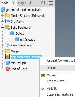

Gabriel_Watson
The best method (in my opinion):
1) download Mesh Enabler and make sure it is loaded under Tools > add-ins: https://apps.autodesk.com/INVNTOR/en/Detail/Index?id=6950391119076900441&appLang=en&os=Win64
2) open the OBJ file from Inventor (or drag it from Windows File Explorer and drop over an Inventor instance/window);
3) convert the mesh feature into solid (cannot attach the result because it's over 40 MB);
4) delete the mesh feature afterward;
5) create your split and hole as required.
