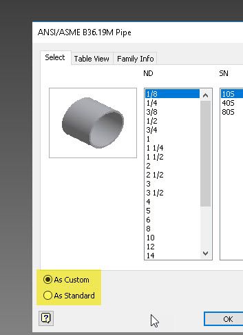

So the issue I have is that I have made a variable pipe that I have uploaded into content center.
The idea being that I should have fixed sizes. But the lenght should be an input everytime I use it in an assembly.
This works great for all parts that have only fixed parameters.
However when I pull the pipe into the modell It forces me to create a new part file for every lenght I use.
Is there some clever way to get around this?

When you place from content center, is it being place "by standard" or "by custom"  Two options in that dialog.  However to be "by standard" each standard member has to have an unique file or member name.  Meaning the member name column must include the length column from CC.
When placed by custom, it prompts for file name and file location.

When you go to place..from content center what is selected here
and under tools/application options/content center tab
Mark Lancaster
So simple and obvious! I should have realised this from the first comment!
Thank you all for your help! This has been solved
