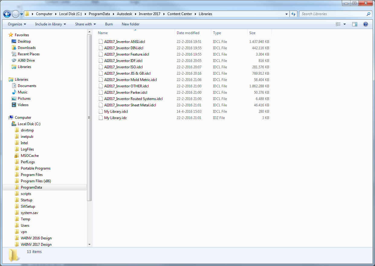

By default your Libraries are placed on:
C:\ProgramData\Autodesk\Inventor ????\Content Center\Libraries
You can  check you path within the Application Options -> Content Center Tab.
