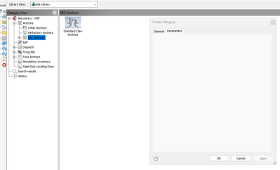

Hi, I was setting up a content center. In the editor, when I tried to map parameters in this window, the mapping table is not showing. Can anyone please tell me where am I missing?

jan_priban
terminology - I use word "category" (not folder)
it depends where (under which category) you create category. If you create new category under an exiting category then new category inherits mapping from parent category + you can add new ones category parameters mappings.
But when you create new category under root category or category in category with no category mapping (your case) then there is no mapping by default. You can still add yours.
https://help.autodesk.com/view/INVNTOR/2023/ENU/?guid=GUID-24D28882-5F45-4E55-B539-0A920F2D6FB1
