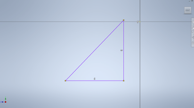

Hi All
Really not sure if this is working correctly. When I try to constrain a line vertically it turns the line horizontal. When I constrain horizontal it turns the line vertical. I'm confused. Please help!

TheCADWhisperer
Your image does not show the XYZ triad.
But note the thick black axis line - this represents Horizontal.
Note the thin black axis line - this represents Vertical.

robertast
The vertical or horizontal line depends on how the UCS stands. Not like your screen
SBix26
The quickest way to solve this is to rotate your view 90°.   That may sound dismissive of your issue, but it truly is the answer, because "horizontal" and "vertical" are relative to the sketch coordinate system, not to your screen or to the part's origin.  The sketch coordinate system is defined by Inventor based on algorithms that we users have no control over.  The sketch coordinate system can be redefined, if necessary, but I've very rarely seen a need for that.
Probably the easiest way to deal with this is to turn on visibility of the axes and/or the sketch coordinate system indicator, so that you can easily see which way is which.  The X-axis is slightly bolder than the Y-axis if you have them visible.

swalton
Remember that each sketch has its own internal coordinate system.  Autodesk created a black-box algorithm to automatically create the sketch coordinate system.  The internal x and y directions are NOT required to be consistent with the origin geometry. Instead the algorithm grabs convenient geometry that exists in the model and assigns a local +x and +y direction.  I believe that the sketch x axis is the horizontal direction and the sketch y axis is the vertical direction. There is no chance for the user to control the sketch coordinate system at sketch creation.
It is possible to manually re-define the sketch coordinate system after sketch creation.  It has to be done outside the sketch environment, and is easiest if done before any sketch geometry is created or projected.  RMB on an existing sketch to get the Edit Coordinate System command.   See the screenshot below.
If changes to previous features delete or alter the geometry that the sketch coordinate system algorithm picked, users need this command in complex models when edits/new features are added to the model tree before the sketch.

johnsonshiue
Hi! Another option is to create a UCS object and sketch on its XY plane, so that the coordinate orientation always persists with the origin XY.
