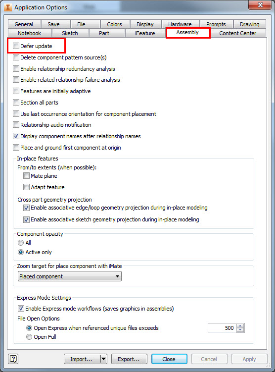

Like JDMather described. Can you make a screenshot of your problem.
I think that the greyed out problem comes because Defer Update is checked within the application options.
Cleaqr the checkbox and try again.

It was a "defer update" issue.  Since I unchecked that box everything has working properly.  Thanks for your help!!
