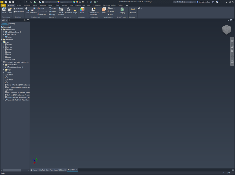

Suppose you got an assembly with a part containing work geometry. Now by whatever reason (better oversight, show someone what's behind, ...) you want to temporarily make it invisible - so you select the part and uncheck visibility (or press Alt + V).
Then, when you want to unhide it, the visibility is somehow passed on to all working geometry and also some sketches inside that part.
1. Hide the part inside the assembly
2. Unhide the part by checking "Visibility"
Now: somehow all working geometry and unused sketches are visible (which they should not be).

johnsonshiue
Hi! I could be wrong, but I think this has something to do with Design View Rep management. I assume the part you created on Step 0 was created in place from scratch, not inserted. When you changed the visibility of the part workplanes, it was also done in the assembly, not within the part itself (open in its own window).
There is a subtle behavioral difference in terms of Design View Rep. When it is done in an assembly, the change only applies to the work geometry in the context (of the assembly). It does not persist back to the part file itself. Then you make the invisible part visible, and the visibility state go back to as if the part is freshly inserted (honoring the visibility state in the part).
It would be nicer if we reverted back to the visibility state before you make the in context visibility change. If you factor in Undo plus context switching is allowed (n-level deep), the behavioral model will become unmanageable fairly quickly.
The current behaviors are not ideal for sure. It is confusing and hard to understand. But we don't have a good solution to make it nicer without breaking other behaviors unfortunately.
