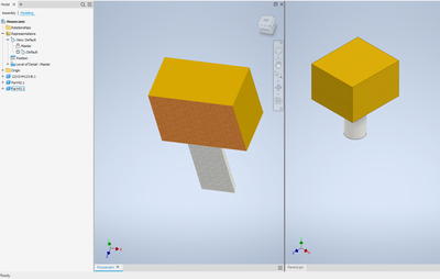

I have a multi body part and I assign different colours to the the various bodies.
Then I use the make part command and click link face colour to the bodies.
When I open the new parts that are derived from the the multi body part the face colour is right but when I section that part it takes on the colour of the template that was used.
Then I have to individually go and assign that part with the face colour and this takes so much time when you have lots of bodies and many projects
Please fix this so that what ever colour you assign to the body or face it comes thru exactly like in the multibody part and we don't have to repeat the process.

johnsonshiue
Hi Anthony,
I think you are talking about the ability to link material style. The graphical section honors the material appearance style. The active material style in the part template you selected to do Make Components (Make Parts) dictates the coloring of the section. I guess you could build templates with different active material style. When you do Make Components, select the desirable template file accordingly.

johnsonshiue
Hi Anthony,
The behavior you are seeing is due to the fact that the section color depends on the material appearance. But, when you use Make Components to push the bodies as individual parts, the the material style associated with the source part isn't "derived" or carried over to the pushed parts.
This behavior shows two major deficiencies. 1) Inventor does not support material style per body. You cannot assign material style to a body as other CAD tools do. 2) Except in a sheet metal part, the material style in the source part isn't derived or linked to the derived part.
Another deficiency is that the sectioned face color is based on material appearance, not the body appearance. There is no option to allow that.
I fully agree with you that the behaviors are not desirable. However, I personally cannot offer any better solution than merely explaining the behaviors. I am sorry.
