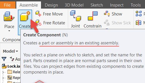

A coil is a part.
Therefore you must start a new Part (Component) within the context of the assembly.
mcgyvr
Coil is a part level feature.. You need to be creating a new part.. Which can be done in an assembly via "create" from the component pane of the assemble tab..
This might help you..
