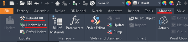

I think this  must have something to do with Vault and Inventor as I have only had this come up twice before and both customers were using Vault and Inventor, and it was Inventor 2021 if I remember correctly. I believe the steps to solve were
  1. Open and checkout the problem assembly
  2. Use command "Rebuild All"
  3. Use command "Update Mass"
  1. Save assembly and all references
  2. Close assembly and all open files
  3. Re-Open assembly
If this solves your issue please mark this posting with the "ACCEPT SOLUTION".

I've tried that with no luck. Even opening every part and sub in the assembly and rebuild aso.
Just found one solution/workaround myself: I chose Save As - as a new model and then i'll have to ferkle the correct name back and hopefully it will just go back into Vault as the latest version. Don't want to loose any history.

Hi! This is a mysterious scene corruption defect. We had implemented a fix to clean up the corrupted scene. But, the source of corruption is unknown.
Typically, you may do Rebuild All and Save -> Close -> Reopen. The issue should be gone.
