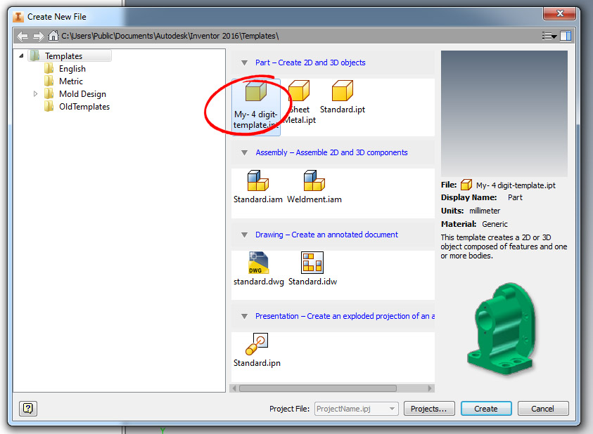

admaiora
You can save it simply as template
Admaiora

bobvdd
@admaiora  Your solution with template would solve the default precision when creating new dimensions but it would not affect the default precision when MEASURING , right? Unless I completely misunderstood.
Cheers
Bob
