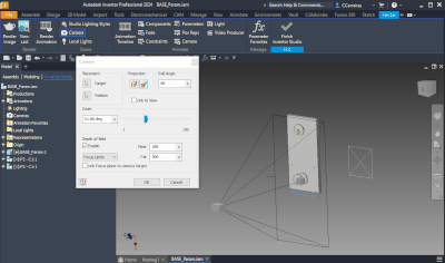

I am trying to create an accurate representation of a camera field of view for a camera I am installing in a room. When I create a camera in Inventor Studio to do so, it looks like I can edit the horizontal field of view with the "Zoom" feature. However, it doesn't look like I can edit the vertical field of view, meaning that the aspect ratio of the camera is fixed. Is there any way to edit the aspect ratio or change the vertical field of view?
Thanks so much.

I'm not sure if it helps, but you can rotate the camera:
Tip:
Inventor has render capabilities, but render is not the main objective of using Inventor, the intent is to create a quick render... so if you want to use detailed settings, maybe, Inventor it's not the better option to use for render.
If you have the Collection you will have 3DMAX, where you can open the Inventor model to do realistic renders with a lot more options.

Thanks so much! I'll try the rotate; I do have 3DS Max, and have been wondering if that's the solution instead of using Inventor.
