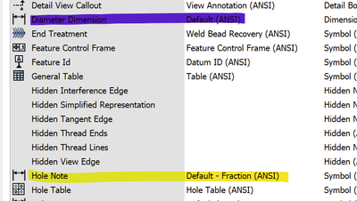

Frederick_Law
I have separate Style for fraction and different decimal places.
You can set different Dimension (Linear, Radial, Diameter, Hole Note) with different default style in Object Defaults.
What you have done is set them all in one style.
Split them up so you can use different style for each Dimension Object.
foolishgrunt
If I'm understanding you correctly, that's exactly what I have done. I have two separate styles for decimal ("Default") and fractional ("Default - Fraction"): the object default for the regular dimension tool point to the "Default" style, while the object default for the hole note points to "Default-Fraction."
What I want is a way to allow a one-off exception: for a single dimension (and not any for the other dimensions in the sheet) to point to the "Default - Fraction" style rather than the "Default" style.
