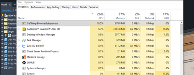

pankaj-cradlewise
So the saga continues in 2023.2.1 Update also.

johnsonshiue
Hi! Unfortunately, the 2023.2.1 does not contain the fix. The fix will be in the coming 2023.3 update (March/April). It has been verified on an internal build.
Many thanks!
Software Test Engineer
