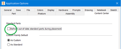

You can also go to: Tools > Application Options > Content Center Tab > Standard >and check the "Refresh Out of date content".

this is because you are placing CC part you have already placed, means you have already such IPT in you cache - folder defined by your project
There is option under Application Option to refresh standard part when you are placing CC part (what you are asking for), but unfortunately it does not work - we are aware of it, issue is being working on
So, what has been said here is correct, add new column and map it to Member.Color property
New instances follow new color, for exiting use Manage -> Refresh
