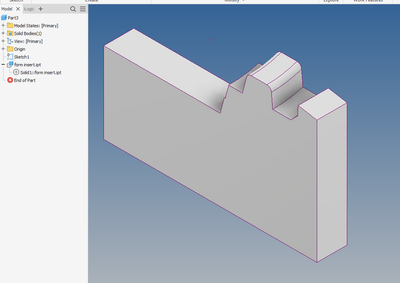

I want to create a sketch that "traces" the outline of this model, but I cannot select it when I am trying to use the parallel constraint on it. Does anyone have an idea? Thanks in advance!

JDMather
Project Geometry.
(In this case you might want to Project the Face in one click.)
Attach your file here if you can’t figure it out.

JDMather
@ninthabandit
I am not at my Inventor machine to check the ipt file that you attached, but from the image I do not see a Projection.
If you do actually have it projected,(but not shown in your image) my next thought is that the edge is defined as a Spline and not as a Line.  But you can Offset a Spline if that is what it is.

ampster40
the lower surface where that face connects has a radius, suspect this may be giving you an issue.
Not sure where "from insert.ipt" came from but that reference file is missing from your original attachment.  Providing that file may assist us in coming up with something that works.
edit, following along with JD's suggestion about projections, I also tried simply projecting the lines you show you are attempting to "offset" (that is what you would typically do here) and in mulitple attempts it fails in particular to the line you are experiencing issues with.  So the normal method of offsetting an existing profile doesn't work either.

johnsonshiue
Hi! I suspect the target edge may not be straight. Try creating a workaxis on that edge. Does it work?

BeKirra
Yes, agreed with @johnsonshiue.
I also guess it is a curve with a large radius (i.e. oval) or it is a spline in the sketch.

JDMather
The edge is a spline, not a line.
You can Project the face and the Offset the Projected Geometry.
If this Offsets more than you want you can toggle the extraneous to Construction...
BTW you could have observed that the projected edge was not a line by sketching a line from endpoint to endpoint and zoomed in...
