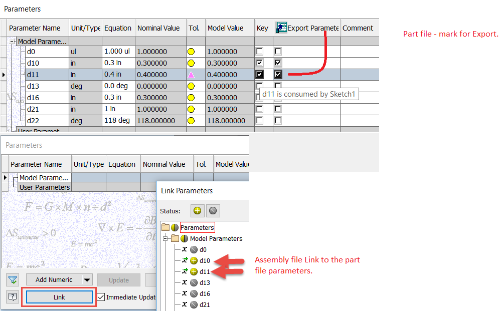

Try this -
In the part file mark the desired parameters for Export.
In the assembly file Link to the part file and select the desired parameters.
(Actually, you can do this in one step from the assembly as Inventor will automatically mark selected dimension for export (and give you notification).
If you also want the Extrusion Depth then I suggest that you give it a named parameter in Part 1 and link all the way through into Derived and Assembly.
