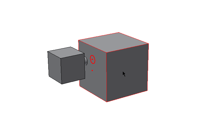

DRoam
One of the issues brought up in this thread as that you have to apply constraints to get Adaptive parts to update. Adaptive parts don't update on-the-fly by dragging in the assembly. But it would be great if they did, something like this:
There's no reason Adaptivity shouldn't work like that (I explain why in detail here).
If you agree that Adaptivity should work as shown in the above video, please help get that functionality implemented by voting for the following enhancement request in the IdeaStation:
Vote here for Adaptivity to work as shown above: Fix Adaptivity (make it truly adaptive/flexible)
