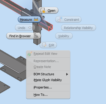

Can't delete or add constraints in assembly
khwilkinso
This assembly has many things either grayed out or simply not shown.  I don't have any positional representations set so it's not that.  When R clicking on a constraint in browser, I don't see my normal options (delete being one of them I need).  I only see
When right clicking on the component, I only see
Please Help!!!

Message 2 of 10
Cadmanto
Looks like the reason is because you cannot edit the constraints of a Frame Generator component member.
Has to be done through either editing the skeleton part or through the Frame Generator itself.

Message 5 of 10
khwilkinso
2020 version
Message 6 of 10
khwilkinso
I don't believe the particular part I'm R clicking on is a frame generator part.  It's just a content center part that I made two lengths of with a table.  What's strange here is that all parts within the assembly act the same giving me very few options to choose from and never letting me delete any of the existing constraints.  I was able to delete a constraint using iLogic but then I couldn't place a new constraint.

Message 9 of 10
johnsonshiue
Hi! There was a similar thread exhibiting the same behavior. It seems that the iam file you are editing is like an iAssembly member file. A typical member file should be readonly. None of the editing command should be allowed. Somehow BOM command is allowed.
The file is corrupted in this state. Do you know how to reproduce it from scratch? Something does not look right to me.
