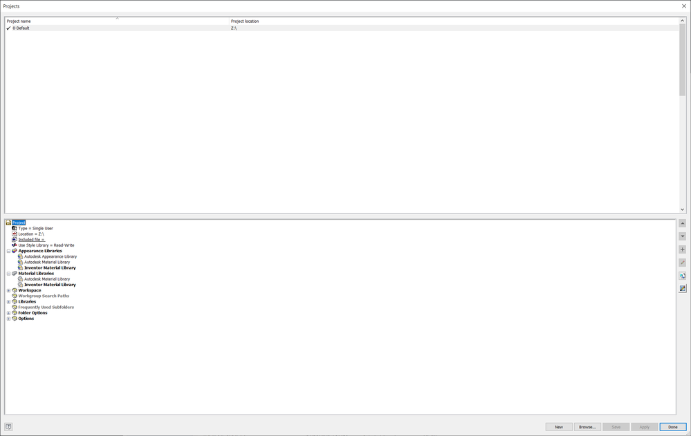

Check if your InventorMaterialLibrary.adsklib is read-only or not (under properties in Windows Explorer). Also check under Get Started (tab) > Projects > select your project and see if your style library is Read-Write, if not, right-click and switch to that:

   Thanks for dropping by. Your reply had me momentarily hopeful, cause the project was set to read-only for the appearance library. However, changing he setting didn't change the behavior, for some reason. here are the details to be sure:

Project settings you referred me to:

jwmb224
the default project is at "read-only" for the library, and Inventor doesn't let me make any changes to the default project:
and i checked, the file is not marked as read-only in windows explorer.
