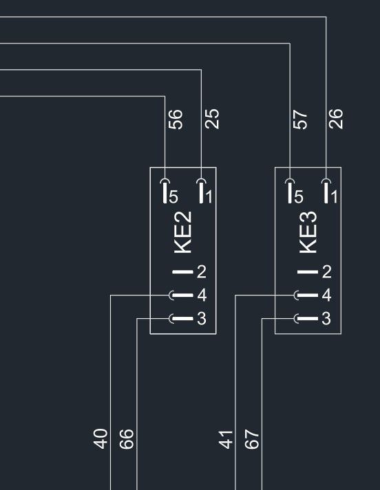

Eddy, something I did in a very large, complicated harness, is that in the instance properties of my ferrules/slip on terminals is I made a property titled "Tag", and I made the value of where that terminal is connected. So for example, we have a SPDT relay that is labelled KE2 on the wiring diagram, and each terminal on that relay has a number. So the instance property named "Tag" for one of the slip on wire terminals is "KE2:5". I wonder if it's possible pull that information from the harness data into the nailboard.
As for making wiring diagrams, it is possible to have Inventor and AutoCAD Electrical interoperability. We attempted it years ago but it seems to only work if your harness has no ferrules/slip ons and the wires connect directly your parts.

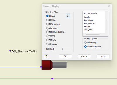

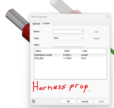

Interesting, this could work with the "Display properties" button in the nailboard environment, however according to the documentation it only displays "Harness properties", I can add custom harness properties like "TAG_Elec" but I'm not sure how to make an expression that relates it to the instance properties. I attempted "=<TAG>" but it didn't work for me.
