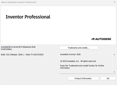

Hi
This issue does not occur in version 2026.1.
Have you installed all Inventor updates on your computer?
Kacper Suchomski
llorden4
Indeed I have, and my mistake for not noting my current version.
Autodesk Inventor Certified Professional
