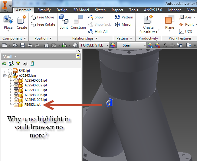

This time the Vault browser.  In earlier releases, can't speak for 2014, but in 2013 when you selected a part in the graphics window it would highlight that part in the vault browser.  This function appears to have been removed in 2015, the below screenshot is taken from SP1 Update 3.

While looking at the Vault browser, you can also highlight a part in the graphical window, then click on a part in the Vault browser, and it won't remove the pre-existing highlight, resulting in two different parts highlighted simultaneously.
You can also then click in the graphical window in empty space to "unselect" everything, and the part you last selected in the browser window will still remain highlighted, even though it is not highlighted in the graphical window.

Neil and Robert,
I could see the issue as well. We will get this logged and send to development team to take a look. Thanks for reporting this issue.
