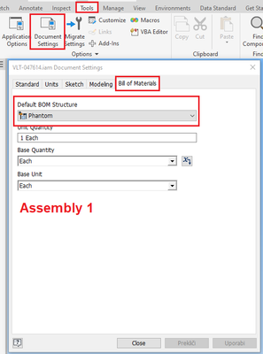

I guess title is a little confusing, but I did not know how to write it in otherway. Pictures will help clear the issue.
I am using Inventor 2020.3.4.
How to simulate:
  1. I have a model - "Assembly 1". In it's "Documents Settings", under "Bill of Materials", it is set as "Normal" in Default BOM Structure.
  2. I put this assembly to it's parent assembly "Assembly 2". In "Assembly 2" BOM, I switch "Assembly 1" to "Phantom". It is the same if you go under "Model Data" or "Structured" - only difference is, that in "Structured" "Assembly 1" disappears, due to being "Phantom" (that why second picture is in "Model Data" tab).
  3. Go back to "Assembly 1" "Documents Settings" and check it's "Default BOM Structure". It is in "Phantom", why??
The problem is, that we want to have for example "Assembly 1" as normal and then we would like to decide in it's parent assemblies if it should be "Normal" or "Phantom" or something else in that specific assembly. Basically it should not have the same BOM structure in every assembly.
This also causes a problem that we are unable to "lock" or "assign item" to these assemblies in Vault. Because assemblies needs to be "NOT phantom" to be able be locked or assigned, but you need those assemblies as phantoms in parent assemblies. Kinda LOOP problem.
It this a bug?

Inventor components are limited to one Default BOM setting.  A component will be normal, purchased, phantom, etc.  Changing the BOM setting in Assembly 2 will change the BOM setting for all instances of the component wherever it is used in any of your designs.
It is possible to switch between the default (as designed in the component's Document Settings interface) and Reference.  To do so, RMB on the component in the parent assembly and look for the BOM Structure menu pick.
Inventor does not allow you to have what you want with a normal assembly.
I don't know if iAssemblies allow control of the BOM setting for each member assembly.  I doubt it.
Untested workflow:
You might be able to create a "wrapper" assembly.  Set Assembly 1 to phantom.  Create a new assembly: Wrapper.iam.
Place Assembly1 in Wrapper.iam.  Set Wrapper.iam to whatever different BOM value you need.  Add some iLogic to Wrapper.iam to pull whatever iProperties you need from Assembly1.

If I understood the issue correctly, the behavior does not look right to me. The BOM Structure property (Normal, Phantom, Reference, Inseparable, and Purchased) can be controlled at the two levels. The Doc Setting dictates the default BOM structure property in the assembly where it is placed within. At instance level, the BOM Structure property can be toggled between "Default" (one of the above types) and "Reference" (deduct from QTY).
So, I am not aware of a workflow to have a component to be "Normal" and "Phantom" at the same time. It should always be "Default" or "Reference."

I found that the BOM property "Phantom" has a different quality (or behaves differently) than the other BOM properties like Normal, Purchased, or Reference. The latter ones can be changed in the context of different assemblies for the same model/assembly file. However, "Phantom" is inherent to each model/assembly file and cannot co-exist alongside the other BOM properties. It excludes them altogether.
I suspect that this has been designed in this way purposefully by Autodesk, for some reason.
