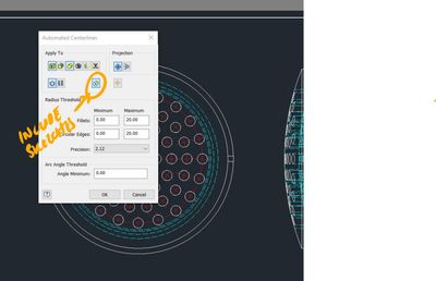

gcoombridge
Automated centreline does work for this. As @johnsonshiue said you can't select the geometry because the edges are not normal to the view. You can select the sketch geometry that created them however - share the sketch in the browser and then tick sketch geometry in the automatic center dialogue box. See attached screenshots...

DustinBTW
Thank you! This seems to be the best solution. Coming back to this today, I was thinking that maybe it was not working because the holes are not on a flat face. Using the sketch was an awesome solution!
I had found an alternative yesterday that involved creating a sketch onto of the view. This method seems better.
