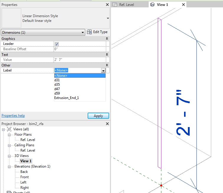

Hi EvanGu,
Thanks, the VBA code is working now. But i still can't edit the geometry in Revit. I exported some parameters like width & length. These exported parameters are "0", you can change them but the model is not updating. The model is still a "dumb" block (non editable).
Maybe you have another clue?
Thanks!
Message 20 of 26
EvanGu
Hi! Only feature parameters (Extrude distance, Revolve angle) can be edited to drive the model update in Revit, parameters added by sketch dimensions in Inventor do not associate to the sketch in Revit. You need to add "Label" to build the connection.
Parameters d31, d35... are exported from Inventor, select a sketch dimension and add label to a parameter. Then edit the parameter, the model can update accordingly.
