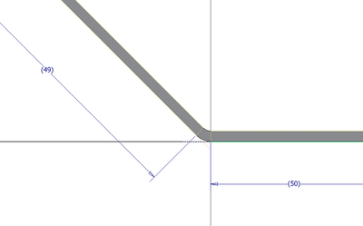

david.karoly
Could you explain me how correction works, becouse it seems wrong.
I tried table from you explanation. Just make 49x50mm and 45° and when I measure, it is always wrong.
I used table from insatalation: C:\Users\Public\Documents\Autodesk\Inventor 2024\Design Data\Bend Tables
Where correction for 45° is - 0,439021
From formula there:  L=A+B-x    it should be 98,560   for radius 0,5 mm
But is wrong after unfold: - 99,380 mm --- Totally wrong!!!
It seems that table do not work.!

Frederick_Law
Leg measurement is to the sharp point.  ie no radius.

david.karoly
I do not understand your advice. I do not measure any radisu, I though that it will be that correction after unfold.
Message 9 of 20
Frederick_Law
You are mixing up two different method:
https://www.adhmt.com/k-factor-bend-allowance-and-bend-deduction/
L=A+B-X deduction, subtraction
L=A+B+X Allowance, addition

You can try very simple example:
i make table for t=0,5 mm and raidus 30° it will be x=0,5
Then sheet metal 50x49 mm
Where I see result 99,036 mm what makes no sense.
Message 18 of 20
Frederick_Law
Message 19 of 20
david.karoly
I see it must be to intersection point. Thank you.👍
