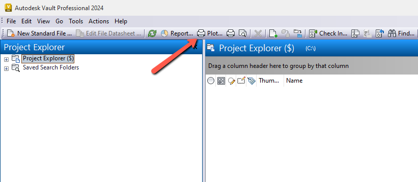

steveh5
@danny
Do you have Vault Professional? The Plot button may do what you are asking. It at lease works for us on A and B size paper. If you grab a bunch of .idw's it will print on the appropriate sized paper.
