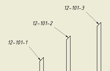

Thanks. Your advice is very helpful, but I need one more information to make it perfect. See figure below.
How to define "start point" of leader text? I want to obtain this effect:
Thanks!
johnsonshiue
Hi Tom,
I could be wrong but I don't think there is a way to change where the leader line starts. It seems to always start from the center of a sketch symbol.
Thanks!
