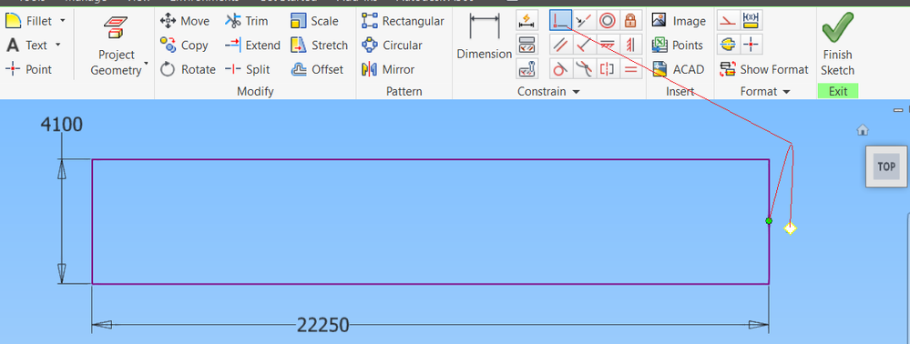

OK, let's get started on this.
Start a new Metric mm file.
Turn on the Visibility of the Origin Center Point.
Start a new sketch on the Top (XZ) plane.
Create a 2Point Rectangle to the left of the origin and dimension 22250 x 4100.
Add a Coincident constraint between the Origin Center Point and the Midpoint of the vertical line as shown.
Save file as Frame Skeleton.ipt and attach the file here for the next step.
What do you notice happen to the sketch when you add the Coincident Constraint as directed?
Message 19 of 22
@JDMather - thank You sir.
it gets fully constrained, changes color from green to blue (and repositioned with that vertical mid point in the origin midpoint),
Message 20 of 22
JDMather
Fully constraining the sketch to the Origin Center Point makes it trivially easy to edit the entire frame later on for adjustments.
Continue adding the lines as indicated in image below.
Note that there are no repeated dimensions. (no extra work)
Note that the one angled line is a mirror of the dimensioned angled line and therefore does not require any dimensions.
