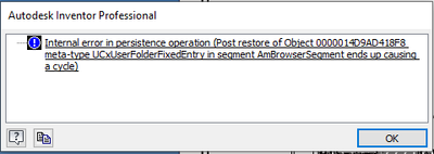

Hello everyone, hoping someone out there has had a similar issue and can offer some solutions.
Back in October our entire department updated to Inventor 2024.1 and Vault Pro 2024.1. the upgrade process with smoothly for everyone but one of our users started to experience the following error on a weekly basis since then. It happens once a week to only 1 user but never at the same time or day consistently, she once had 3 in a single day.
1. She would open and work on an assembly like normal.
2. She would save and close the assembly (sometimes checking into the vault, other times not just to switch to another task or go home for the evening).
3. She would go back and open the assembly only to get the following messages:
(ignore the file path, this is just a Onedrive copy I keep on record to show the error. Doesn't matter if I get it from the vault or copy it from her system, the same error persists.)
4.After hitting Okay she gets:
" Internal error in persistence operation (Post restore of Object 0000014D9B49D8F8 meta-type UCxUserFolderFixedEntry in segment AmBrowserSegment ends up causing a cycle)"
5. After this occurs the assembly is corrupted but all of the parts are fine, allowing her to rebuild the assembly and not have any issues other than time loss.
This problem has happened on assemblies that have been un-vaulted as well as assemblies freshly checked into the vault.
Here is a bit of a background on our department set-up:
-10 users All using the same vaulted components, project files, templates, libraries etc.
-Common settings and file paths are used during the upgrade process to have everyone pointing in the right direction.
-Common drawing techniques and processes (most users come into the department with only the bare minimum of Inventor knowledge and get trained the same way).
-We all use Autodesk certified workstations from HP/Dell.
-The only person with access to editing these templates, libraries and other common files is myself. All of these files are kept in a "Released"/Locked state to prevent accidental changes.
-The only Add-ins we use are Woodworking for Inventor and InsertPlus. Again this is department wide
-We use Multi-Solid bodies top down designs
Solutions we have tried so far:
-We have replaced her computer Twice! (Both times with brand new computers. Once was the same time as a new hire using the same install process and setups, the new hire has never had issues).
-We have created a new Windows Domain account for her at a computer upgrade
-New vault account created as well
-Verified all network connections, have even moved her across the office to an entirely different set of ports
-We have been in constant contact with our Reseller and have had an Autodesk Tech review the corrupted file and our system setups (only thing found was something reference to Void Tools which one user had on his computer in the entire network. This has since been removed months ago but the problem persists on units he never touched)
-No errors show up in the Windows Error log or on the Vault Server logs.
I have searched the forum for the same error but none of those results have helped this situation. Most results recommend replacing the computers in question but we have already done that twice to no success.

Message 2 of 28
mluterman
I make no guarantees, but we've had problems like this on a computer with a corrupt Windows User Profile (and I can't remember if it was Inventor-related). I don't know why this happens, but once a new (admin) profile was created in Windows, everything worked. Will it work here? Who knows? Just a thought.
Message 3 of 28
chris
This has been suggested before but our IT department runs our accounts on Window Domain profiles (so people can log into any computer if need be). We created a new Windows Domain for her from scratch the same time we gave her the 2nd new computer. Thanks for the suggestion!
Message 4 of 28
johnsonshiue
Hi Chris,
This sounds that some of there is a cyclic relationship among files. It should not be environment related. It is more about the workflow. Please ask the user how she create the Inventor files and what she has done with the files.

Message 5 of 28
chris
Thanks you John for the reply! I have passed onto our IT department and I guess we will have to wait a week or 2 to see if it fixes the issues.
A few things to clarify:
1) All our files are always saved locally and then checked-in to the vault. The onedrive location is where I keep a copy of the corrupted files to send our reseller for analysis.
2)I don't believe she is doing anything to cause a cyclic error (at least not purposely). About half the files she works on where started by someone else and she has done as little as add a extrusion (with no projected geometry or outside references) to a part before saving and having the unit corrupt.
3)All of the windows updates should be in place, graphic card is probably a couple of months old from when the new computer got installed. We are all currently on 2024.2. Half tempted to see if upgrading to 2025.1 when available to see if it magically fixes the problem.
I will review workflow process's with her just to be sure but i don't believe she does anything the rest of our department doesn't do on a regular basis.

Message 10 of 28
chris
Hi John
System is fully up to date and as of Monday night everything is on the latest service pack. On thursday we had 1 unit regularly causing corrupted assembly files. I spent over an hour with the user watching her process and seeing corruption happen. We then tried to replicate the corruptions using the information we saw on this unit without any consistency or knowledge gained.
Unfortunately there are never any crashes only the error pop-ups as per my first post.

Frederick_Law
Using ModelState?
Message 20 of 28
Total shot in the dark here, but by any chance are you opening files by double-clicking?
That process has corrupted a number of our files.
Always open the files from within the application, much, much more stable.
