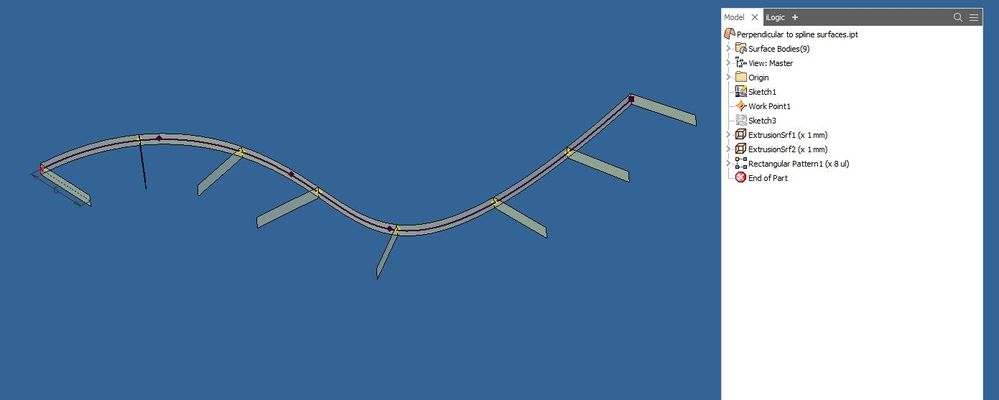

I couldn't get a solution within a 2D sketch, but a workaround with surfaces
2018 IPT attached.

Here is a way.  Inventor 2019.

Hi! Another way is to use Sweep command (a line and the spline curve) to create a surface. The resultant surface consists of infinite number of sections. Each section at any given point on the curve is perpendicular to the curve. Please share your attempt so forum experts can help you further.
