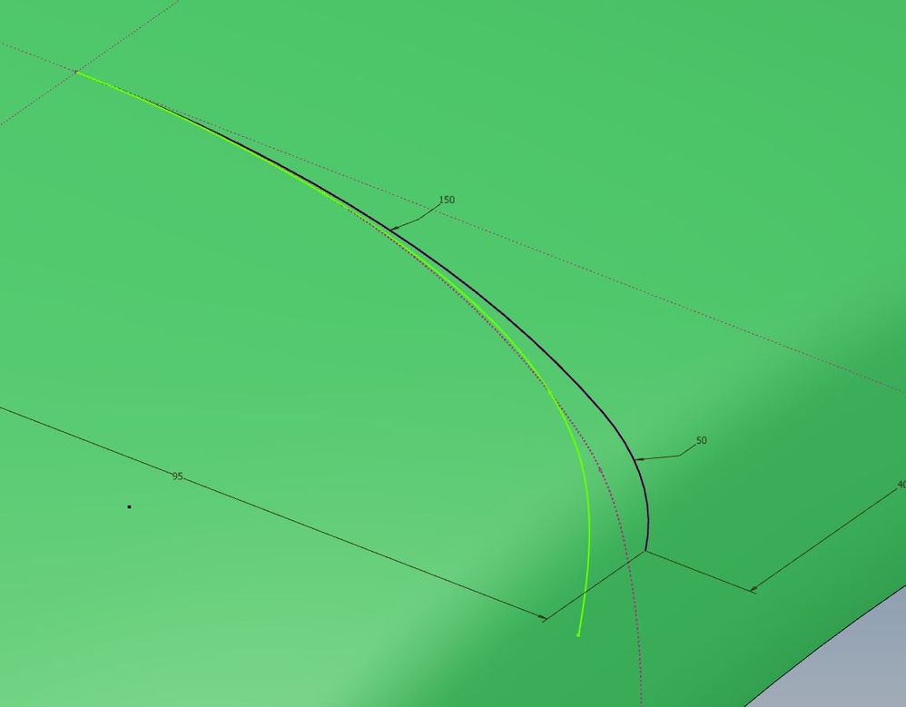

Hello users,
I would appreciate any help to create wrap of this sketch arcs-manually (cause wrap option is not working on the "complex" surfaces).
Here is an image which shows what option I have tried and as you can see curve is pretty much deformed. Vertical projection is not solution also. I would like to have a nice smoothed wrap of curve on the surface bellow.
Regards,
Danijel
Inventor 2018/Windows 10 x64

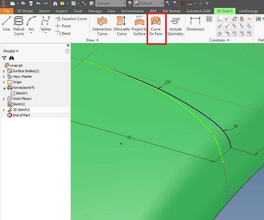

Hi Danijel,
I'm having a little trouble to understand what the sketch really should look like.
If project to surface doesn't give the desired effect then maybe you could make it manually with "Curve on Face"?
You could project your current 2d sketch (Project along vector), convert it to construction and use that as a guide for your curve on face.
Hope it helps!

You don't need to project the 2D sketch, you can make the shape you need just with "Curve on face".
I was just saying you can project the 2D sketch and use it to snap some points of your "Curve on surface" to as a guide.
Not all point have to be on the projected curve.

Sorry JD,
I thought on Sketch2. Yes you are right, this is a spline created by many points (about 500). Reason that I need wrapped curve is to use loft cut function.
We can also use profile created by arcs (please see attached), so maybe it is better for your idea.

What about creating points in a 2D sketch, project those on the surface and make a smooth curve on surface through those points?
Is this something you're after?
File attached.

jamesfgill
Hi Danijel,
I think you can make the 3D sketch geometry you need with this 3 step process:
  1. Make an extruded surface.
  2. Wrap the 2D sketch onto the extruded surface (i.e. 3D Sketch -> Project to Surface -> Wrap to surface).
  3. Project the wrapped sketch to closest point (i.e. 3D Sketch -> Project to Surface -> Project to closest point).
For step 1 I made an extruded surface using the revolve profile:wrap_1.jpg
Here is the result of step 2. The green curve was made by wrap and is on the extruded surface:
Here is the result of the final step. The red curve was made by normal projection and is on the revolved surface.
I used the measure tool to get the lengths of the curves. Note that the original 2D sketch contains 2 curves.
  2D sketch:               [curve 1] = 80.607 mm  [curve 2] = 26.53  mm
  Wrapped sketch:          [curve 1] = 80.604 mm  [curve 2] = 26.526 mm
  Normal projected sketch: [curve 1] = 80.454 mm  [curve 2] = 26.152 mm
The lengths of the 2D sketch curves and wrapped sketch are almost exactly the same, as expected. The computation of the wrap and the curve length both involve an integral, the tiny difference can be attributed to the approximation involved in the numerical integral computation.
The lengths of the 2d sketch curves and the final normal projected sketch curves are a little different. I hope that the difference is acceptable for your application. Note that the revolved surface is non-developable, so it is impossible to wrap the 2D sketch onto it without some stretch or compression.
I've attached the ipt I used. Let me know if you have trouble opening it, I might have used an internal Inventor build that is incompatible with your one.
Best regards,
James
