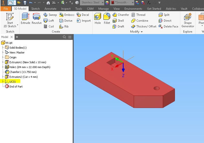

I want to add UCS to the drawing to be similar like at the ipt file
for example I add to this part the UCS:
At the drawing after adding the work feature the result is :
1.JPGThis line doesn't have the properties option to change to different  color (like edge for example) . Only from the styles of the center mark ,if I will change the color of the line I still didn't have the arrow
any suggestion ?
