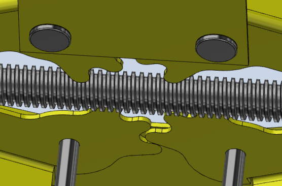

I am trying to create some acme threads can someone please show me how to create the helical sweep to make the cut? I am using IV2021. Thanks.

Scissors ACME.PNGAttach your *.ipt file here.
scoopthepoop2000
Looks good. Can you please post the .ipt of that part so I can see your technique so I may learn how to make that helical cut? Thanks.
